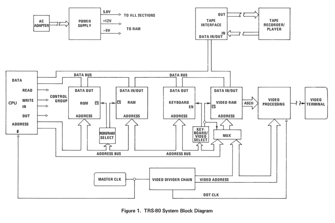

PostPosted: Sun Sep 20, 2020 4:06 pm
Posts: 1949
The Z80-powered TRS80 Model I had a 64x16 monochrome display that was memory-mapped and quite stable. I don't think the implementation of the display degraded perfomance in a measurable way, but I was just a 13-year-old kid when I was a user, and didn't have any detailed engineering knowledge.
PostPosted: Sun Sep 20, 2020 5:17 pm
According to the TRS-80 Technical Manual, it has a separate video RAM whose address lines are muxed between the CPU and the CRTC. So the CPU doesn't need to be halted for display scanout.
