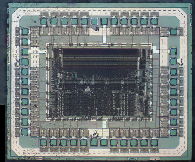

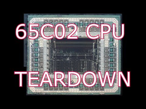

Via Jac Goudsmit on G+, a short video and matching blog entry, from "electronupdate".
This particular version was plucked off of an embedded industrial controller... a place where this processor still finds design wins. The die has patent numbers which were very helpful in sorting down the details of this design.

I think some of the commentary on the chip is not quite right. I would say the floorplan is very like the NMOS 6502 - the area below the decode array will be the so-called random logic, and the more organised area in the bottom half of the core will be the datapath - that's where you'll find the registers, the ALU, and the busses. Note that the decode array doesn't have fuses - it is mask-programmed - but the variable features are indeed the programming of the array.
Lots of white space in the chip, as noted - looks pad-limited, which is not great for price, as the core is such a small part of the silicon.

Very interesting ! Finally we've got better pictures than the tiny ones to be found on WDC's web pages. Maybe some day we'll enjoy even higher resolution since the video clearly shows some zooms on the PLA and the patent numbers. Their CPU seems to come from Sanyo, before WDC's switch to TSMC foundry, it is already a 2-metal process. Too bad that the commentary isn't accurate.
