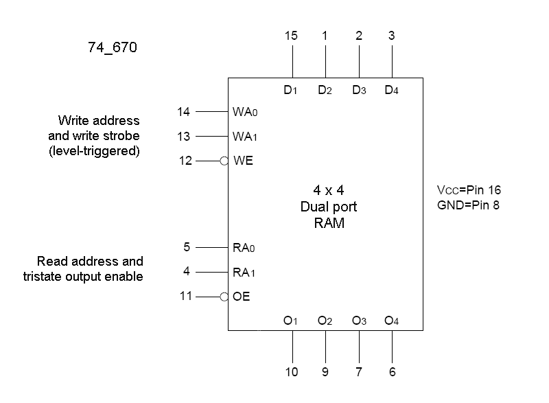

On a related topic, allow me to draw attention to the 74_670 dual-port 4x4 register-file. This little chip is highly suitable for storing & recalling bank addresses, as well as for other applications. I've started a new topic here.
Neat. How about just using an EEPROM as a CPLD replacement for chip select signals? Two 74HC670s could be memory mapped that each refer to a 31k bank. The first 1k is always bank 0 and the last 1k is EEPROM for bootstrapping.
