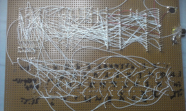

Re: OSI Superboard II replica
Ok, here's the bottom mess:
I've been working on this project for a little while now and have a working wire-wrap prototype. It is based on the WDC65C02 running at 1Mhz using a Parallax Propeller to connect to the 6502 bus for video and ROM emulation. The Propeller also generates the 1Mhz clock signal used for the 65C02. The ...
