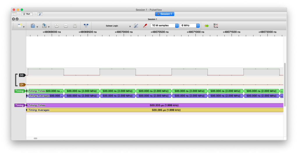

Ha. I kept hoping it was the code! That’d be the easiest to fix. Meanwhile. I’m gonna keep digging!

The math again:
GOLO: LDA (2)
STA (4)
Delay (491)
' Delay Loop:
LDX (2)
DX: DEX (2)
BNE (3 or 2)
JMP (3)
GOHI: LDA (2)
STA (4)
Delay (491)
So, just focusing on the delay loop:
2 for LDX
5 for each iteration (except for the last, which is 4)
This is 2 + 5N-1, or 5N+1...
Between each ...

What I find interesting is that the clock signal is dead on and seems to be measured accurately, whereas the hi/lo is off...

It looks like the regulars here do now know the PAL-1 system.
And a beautiful thing it is, too! Hi Hans. Yours looks so much cooler than mine :wink: . I'm off to checking measurement error cuz I'm pretty sure the code's ok (not stylewize, but cyclewize). I will also do a quick rewrite with a ...

Welcome! Those I/O addresses seem familiar to me. By any chance are you running the code on a KIM-1? :)
I haven't counted up your clock cycles, but I did reformat your code slightly, and it's apparent that the HI loop and the LO loop have virtually identical instructions. (BDD, I'm sure the ...

1Khz Square wave - how much is too much different?
All,
I'm new to 6502 programming. I bought a PAL-1 and I'm learning about 6502 programming and microprocessors. In the process, I found and read Don Lancaster's Micro Cookbooks... great books for folks like me, who never did any hardware or low level programming, btw. Anyway, one of the problems he ...
