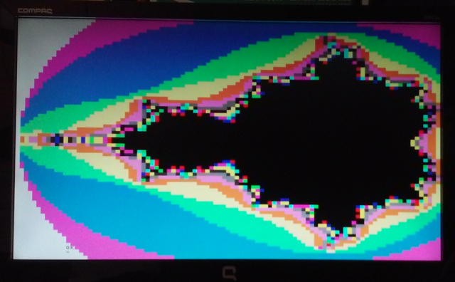

Thanks for the Mandelbrot code. I modified it to generate a 100x75 16-color version on my FPGA-based 6502 system
