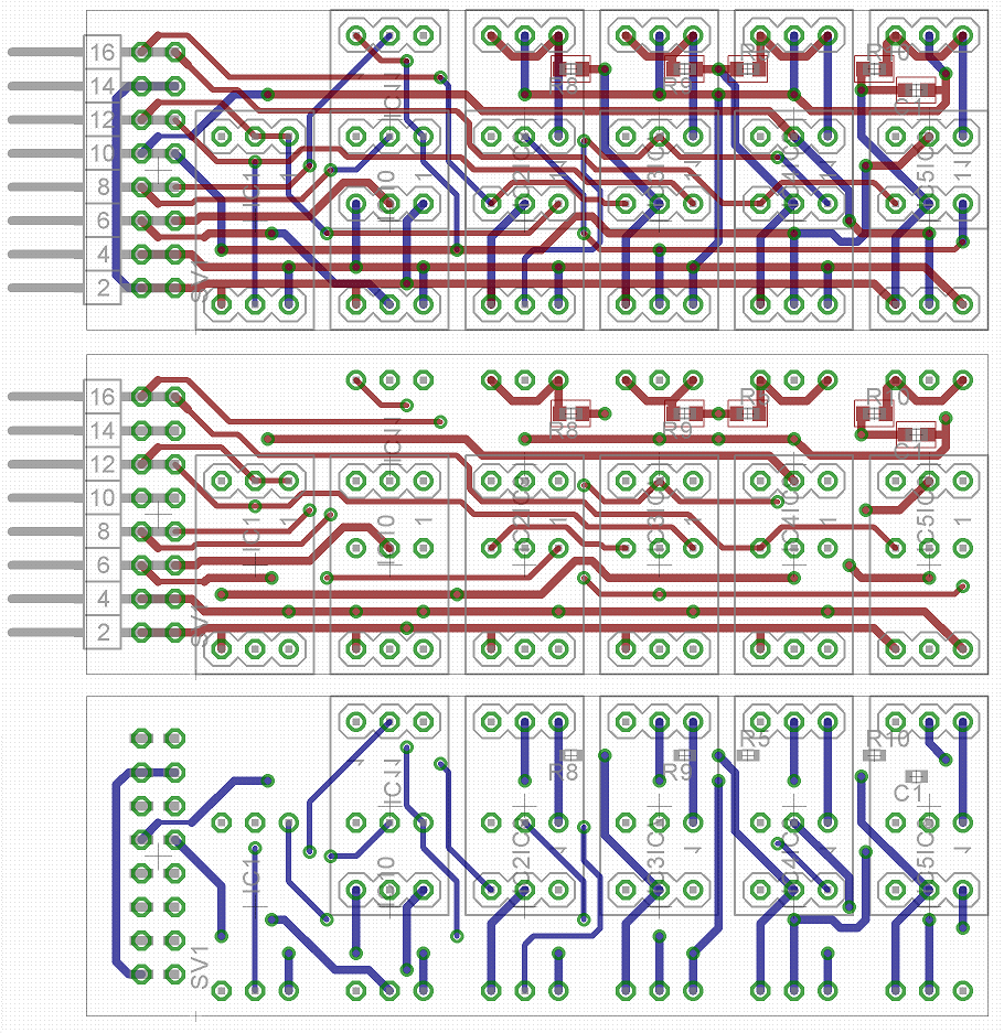

Re: 'transistor logic modules' versus 6502
pla.sch, pla.brd
It's rather big. Note that a 6502 would require 10 such modules.
+3.3V supply, CTL AND based PLA with 22 (buffered) inputs and 15 outputs.
Pulldown resistors at the CTL gate outputs are not included,
because you may want to build big AND/OR combination gates by creatively ...

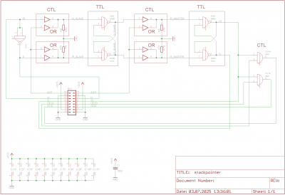

stackpointer.sch, stackpointer.brd //one Bit.
+3.3V supply.
Two CTL outputs with enable.
Pulldown resistors at the CTL gate outputs are not included, because you might want to connect them to bus lines.
+3.3V supply.

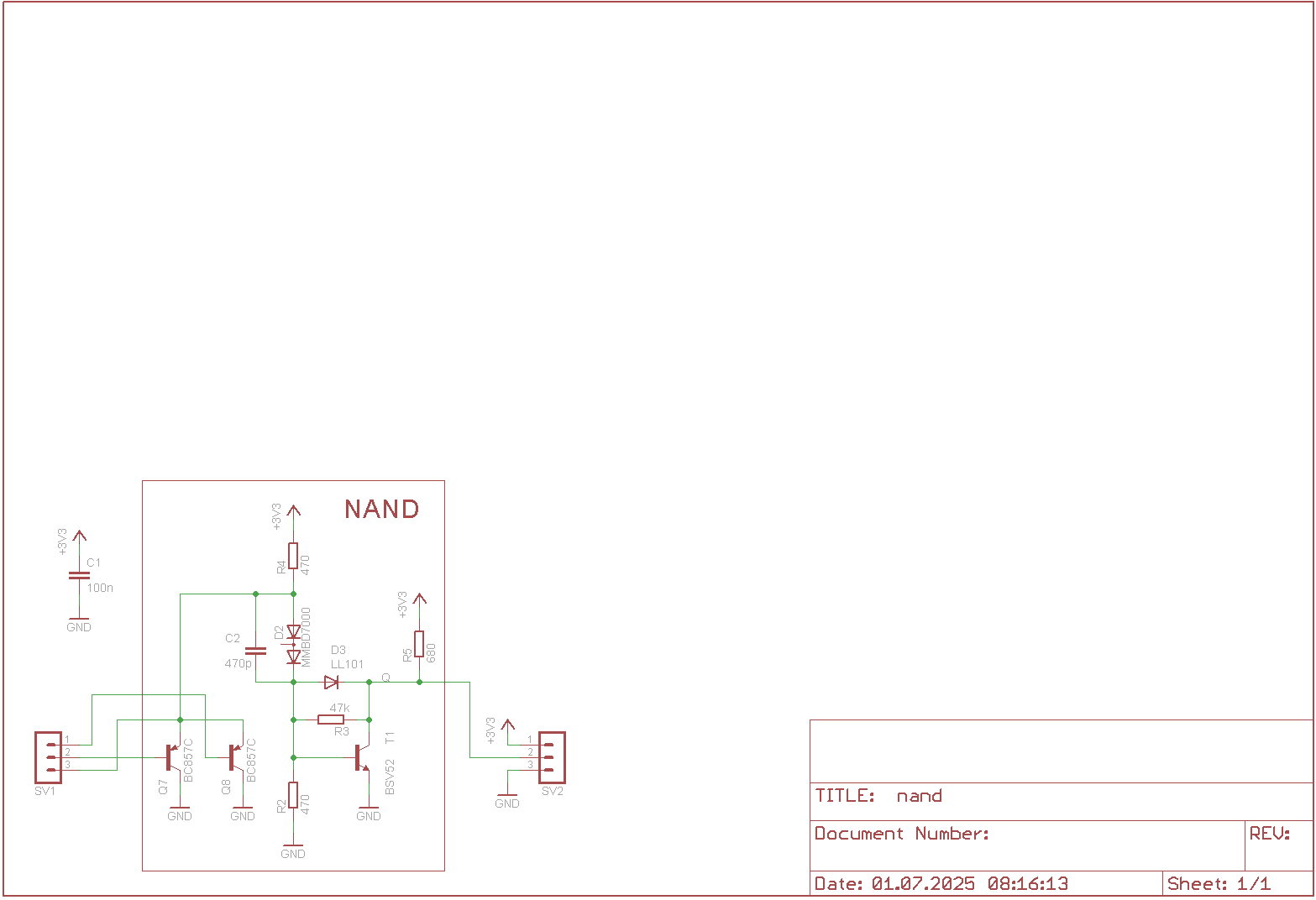

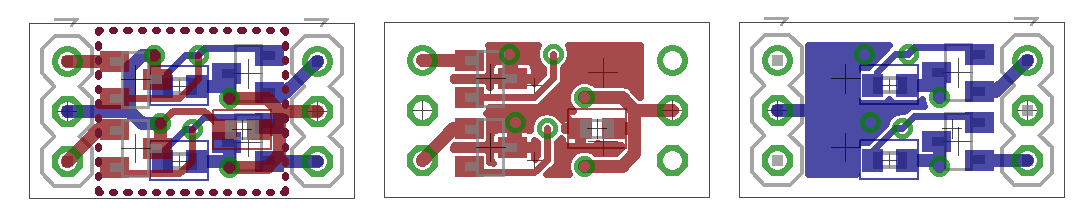

nand.sch, nand.brd
+3.3V supply.
BSV52 based TTL NAND, open collector output with pullup resistor.
2 inputs, expandable with external PNP transistors.
+3.3V supply.

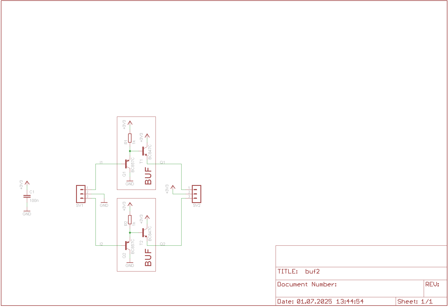

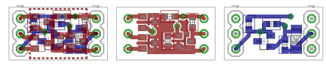

buf2.sch, buf2.brd
+3.3V supply.
Two CTL buffers, pulldown resistors at the outputs not included.
Thing is, that the outputs can be wired together for forming an OR gate.
+3.3V supply.
